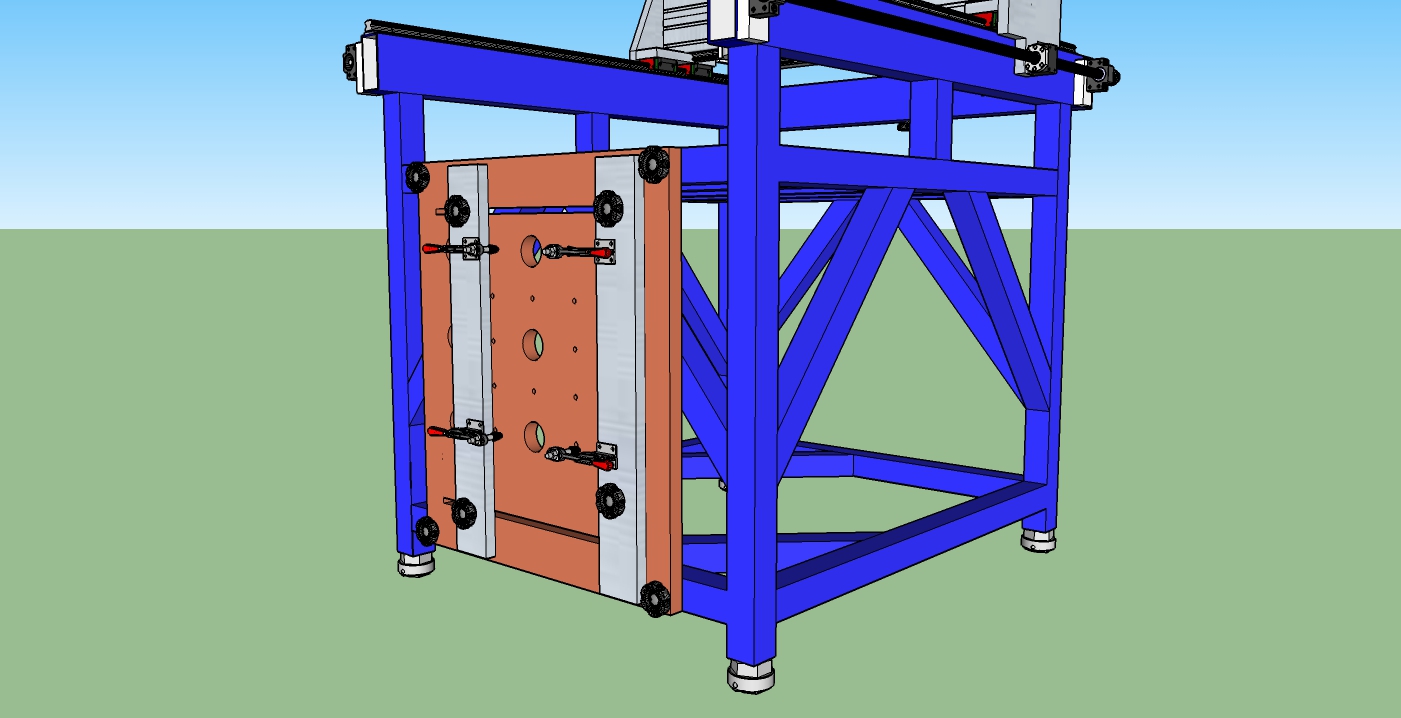

    A small update to the dovetail jig. Since you can easily remove the vertical braces, I figured that you could just clamp thicker things directly to the base plate with clamps - same system as used in the Festool worktable (you can use the same clamps). If you are normally routing items that are not so wide, you can also have one of the vertical braces fixed tightly as a fence to ensure that the work items are perpendicular to the bed.
    If it was me I'd have a combination of 3 things.
    #1 Clamps as shown.
    #2 Matrix Grid of Threaded holes for clamping Odd shapes with mill type clamps.
    #3 several larger holes for Festo type clamps for deep items.
    Oh and I forgot to say I'd get lift those bottom rails up about 75-100mm to create short stumpy feet for levleing and lose 2 of the diagonals wich are not required. Less welding, less chance of heat distortion.
  4. #64
    Yes, good idea JAZZ. Some holes with T-nuts would increase the possibilities for fastening things. I actually thought that I extended the legs under the lower frame, but apparently I didn't. Also eliminated the lower beam I inserted for mounting the dovetail jig. I removed 2 of the diagonals since they are not required.

    Quote Originally Posted by ngundtoft View Post
    One of the things you'll probably use in vertical position is lower bracket or shelf like setup to help support and locate material when clamping. This makes repeat work like dovetails much easier and the Thread holes come in use full for things like this so I'd take them all the way to bottom.

  9. #69
    Hi JAZZ - yes absolutely, some way of fitting an end stop is very practical. I also realised that the "overhang", or working distance from the face of the dovetail jig, is only 91mm. So maybe I should extend the Y-axis rails by 50mm or so.
    Thanks for the links. If this is the type that hanermo2 uses, I guess that you will need 3 - or maybe the Pendant type is just as good?
